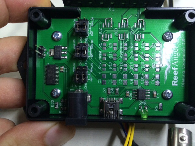

I just received my battery backup controller last night which I couldn't get to work, and I now realized when I ordered my RA back in aug 2013 I asked for my relay box with outputs to be 0-5v pwm. I also ordered a dimming expansion at the same time.
So my question is, Im not sure if that dimming expansion can do 0-10v like the newer ones, or is there some way to make the relay box or dimming expansion put out 0-10v?

Open the dimming expansion and see if there are jumpers to change the signal.

Just got home to check but Yes it does.
- image.jpg (105.7 KiB) Viewed 7610 times
Re: Jebao Battery Backup PWM
That module was custom ordered as 0-5PWM.
It won't do 0-10V.
The new modules have the option to do 0-10V or 0-5V though jumpers.
It won't do 0-10V.
