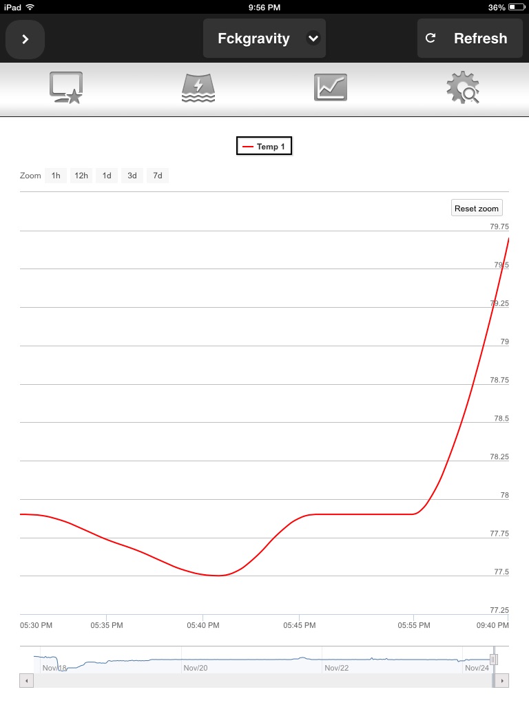

Im not sure why and luckily i was home but the heater relay turned on and didnt turn off for about 3 hours. The temperature in the tank went up a couple degrees so hopefully everything survives
This unit has been running over a year and i havent had any other issues or changed the code. The odd thing is the system recorded everything so there wasnt an issue with the temp prob i dont think. Please help im worried to leave now.

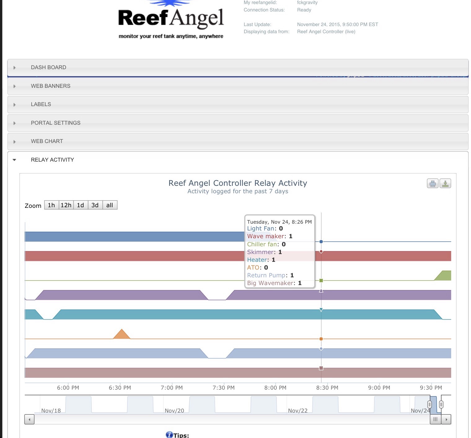

Did you see that the heater was indeed on?
According to your log, the heater was off.
It was a pretty steep rise. How much water and what heater do you have?
Your temperature rose by 4 degrees in 10 minutes.
http://forum.reefangel.com/status/chart ... &filter=t1
218 is when the heater was on at 8:06pm and 206 is when the heater was off at 8:11pm.
Then at 8:16, it was still off and the temperature was still rising and topped 81.8.

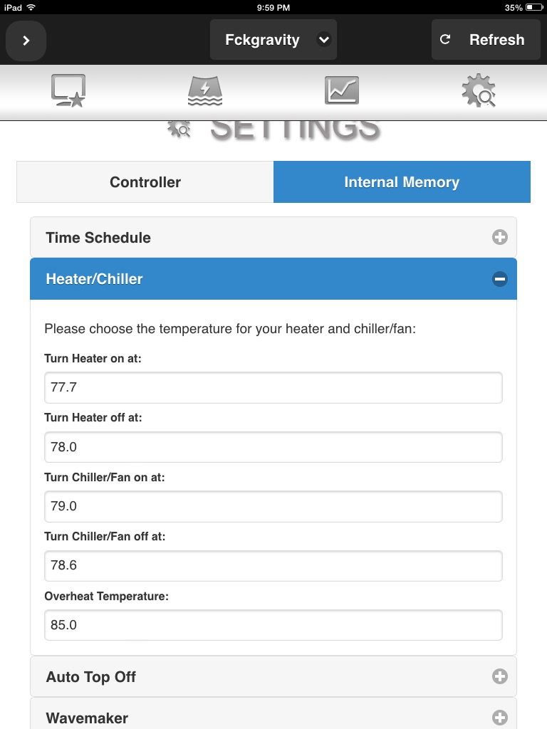

How are you calling the heater in your code. What's the values set in internal memory. Does your heater have it's own thermostat? That may have died and you may need to tighten up your parameters. Could be many things. I'd look to replace the heater soon. Temp probe looks fine but we need to see your settings. Does the relay turn on/off properly?

I did not see if the heater was on during the this time I only noticed because the Cooling fan kicked on at 9:40ish and it never turns on but at that point the heater was off. It must have been on though since the ambient temperature was 72, no lights were on and my Kill A Watt meter said all pumps in total on the tank were pulling 41 watts.
Can you explain to me how to read the log please, from what I see on the portal relay chart and the attached image it turned on at around 5:55 and turned off at around 9:41.
On the link you attached of my webchart it shows no temperature information exactly for that time period if you hover over the red line. Seemingly saying there was no temperature information being provided to the unit so it stayed in the on position.
The tank is 52G net volume and has a 150W heater on it.
The temperature was double checked with 1 digital thermometer and 1 analog, they both showed the actual rise in temperature above normal of around 2 degree's but I dont know how long exactly that took I only checked after the issue.

All of the code was done using the Wizard and the iphone app with no custom code.
The heater does have its own thermostat which is set to 83 degree (which I have now lowered and explains the crazy temperature fluctuation on my webchart around 10:30 as I was testing in a seperate plastic bucket) .
Can you explain why the heater thermostat would matter if power to the heater is temperature controlled though RA relay?I would think the thermostat would only matter if it was set to low and the relay turns on but the heater does not.
The heater is a newly replaced one month old Eheim Jager.
The relay seems to function properly once I saw the problem and checked. During the time period of the heating event I do not know though.

Can you paste the relevant heater code from the wizard output... just need to confirm a few things.
The heater thermostat is important because it provides a backup. You always want to have either the RA doing the override or the heater itself. This way if one does get messed up you have some redundancy. Some people set their heater thermostat and then have RA shut off if it goes over and some have RA control completely and then have heater a slight bit higher as you did. Either way is good, both should try and stay within your limits though.
You also have the overheat status that you could trigger some ports to shutoff... heater, lights, some pumps... whatever you think would help the situation, but that would be something else that could take action to avoid the situation.

I understand the thermostat as a backup I was just confused why that would matter but as I didnt explain to you how I was using the system I understand now.
I do have my overheats sets but I will tighten up the constraint from the heater off temperature. Right now its kind of set for a catastrophic situation.

Ok, I see the problem. You're temp probe must have been reporting 0 during that time. As you have relay status for those duration but no temp, the only answer was that temp was responding as 0 and you're heater was turned on because it's less than your on temperature.

This is what I see:
Your heater is on port 5.
Chiller fan is on port 3
8:06pm - T1=77.0 and heater is on and chiller fan is off.
218 decimal is 11011010 in binary 8:11pm - T1=79.3 and heater is off and chiller fan is on.
206 decimal is 11001110 in binary 8:16pm - T1=81.8 and heater is off and chiller fan is on.
206 decimal is 11001110 in binary 8:21pm - T1=77.7 and heater is on and chiller fan is off.
I can't see how a 150W heater can heat up that much water in 10 minutes.
I also have the same volume and my heater takes a couple hours to heat up 1 degree.
On top of that, you lowered it by 4 degrees in 5 minutes. That's almost impossible without some really heavy duty chiller for that amount of water.
So, I'm very confused how you got these numbers.
This is what I see:

Roberto, I'm getting blank's for Temp between the time the heater was on 5:55 to 9:41

I am getting nothing either for chrome or IE, In the graph link, in my app also the time scale on the bottom jumps from 5:55 to 9:40. and there is a two degree swing.
Well from what I have checked manually with a thermometer and what I can see on the app is the tank did go up 2 degrees over its normal operating temperature. I definetly agree with you rimai If the tank had heated up 4 degrees in ten minutes assuming a specific heat capicity of seawater that would have taken something around a 3 kw heater .
But If the heater was on for the 3+ hours its saying on my graph it would take a 150w heater over 2 hours to heat up the tank 2 degrees F, taking into account all the thermal losses its believable it could take 3+ hours.
There is no possible way like you said it cooled that fast either, plus I don't have a chiller just a fan lol

Ahh... I think it is the time difference.
I'm on PDT, so 9:41 is showing to me as 6:41.
If I decrease 3 hours, I see no temp readings from 2:55 to 6:41, which is what you are mentioning.
So, I was looking at the steep increase showing in your side starting at 11:06.
I'm assuming this is not the right part that you are talking about then, is it?

Re: Please help!!!Heater malfunction
Ok here is the code anyways.
I do have the portal alarms set up, but Like you said I need to tighten them up some I had my over heat set for a drastic situation. I just was putting to much faith in one feature without a backup which was dumb on my part.
Any reason why the unit would not get a signal for pretty much the fist time in two years? Should I switch out temp probes or anything? ....I just got up mid sending this and i picked up the unit and I heard the overheat fan kick on, looked at screen and it said temp was 185 . It quickly flashed and returned to normal so I guess there is a bad connection. I can recreate it if i jiggle temp probe plug
- Posts: 33
- Joined: Tue Aug 06, 2013 5:11 am
rimai wrote:Ahh... I think it is the time difference.
Yes those erratic measurements were from me setting the thermostat on the heater to the reef angel probe readings with the heater in a plastic bucket.
You have no ports defined for the overheat. You should also consider a second probe. You could use the T1 probe for the heater and the T2 probe for overheat. Or we could leverage both with a little custom code. I would look into changing the first one for sure if you can't secure the connections.
