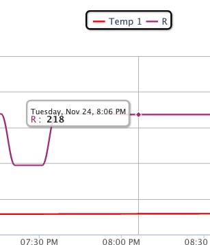

I did not see if the heater was on during the this time I only noticed because the Cooling fan kicked on at 9:40ish and it never turns on but at that point the heater was off. It must have been on though since the ambient temperature was 72, no lights were on and my Kill A Watt meter said all pumps in total on the tank were pulling 41 watts.
Can you explain to me how to read the log please, from what I see on the portal relay chart and the attached image it turned on at around 5:55 and turned off at around 9:41.
On the link you attached of my webchart it shows no temperature information exactly for that time period if you hover over the red line. Seemingly saying there was no temperature information being provided to the unit so it stayed in the on position.

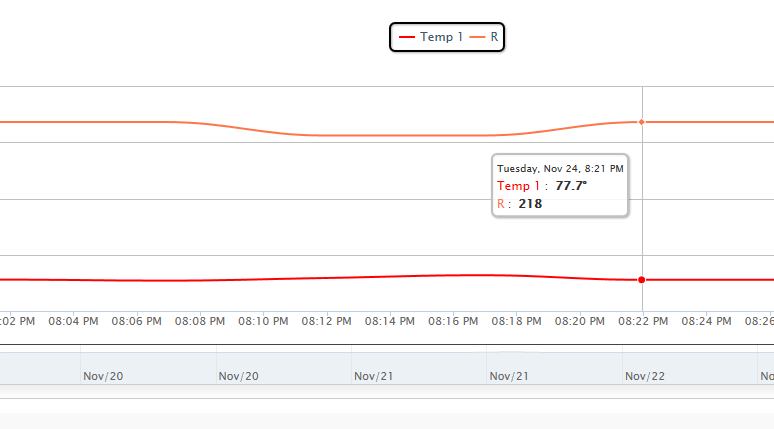

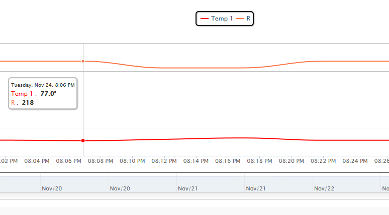

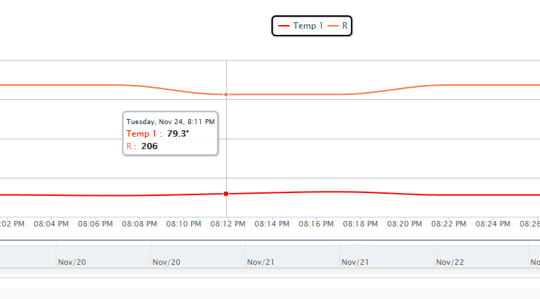

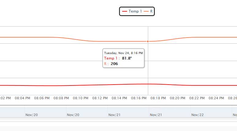

This is what I see:
Your heater is on port 5.
Chiller fan is on port 3
8:06pm - T1=77.0 and heater is on and chiller fan is off.
218 decimal is 11011010 in binary
8:11pm - T1=79.3 and heater is off and chiller fan is on.
206 decimal is 11001110 in binary
8:16pm - T1=81.8 and heater is off and chiller fan is on.
8:21pm - T1=77.7 and heater is on and chiller fan is off.

I am getting nothing either for chrome or IE, In the graph link, in my app also the time scale on the bottom jumps from 5:55 to 9:40. and there is a two degree swing.
Well from what I have checked manually with a thermometer and what I can see on the app is the tank did go up 2 degrees over its normal operating temperature. I definetly agree with you rimai If the tank had heated up 4 degrees in ten minutes assuming a specific heat capicity of seawater that would have taken something around a 3 kw heater .
But If the heater was on for the 3+ hours its saying on my graph it would take a 150w heater over 2 hours to heat up the tank 2 degrees F, taking into account all the thermal losses its believable it could take 3+ hours.
There is no possible way like you said it cooled that fast either, plus I don't have a chiller just a fan lol
Re: Please help!!!Heater malfunction
Posted: Wed Nov 25, 2015 1:46 pm
Ahh... I think it is the time difference.
I'm on PDT, so 9:41 is showing to me as 6:41.
If I decrease 3 hours, I see no temp readings from 2:55 to 6:41, which is what you are mentioning.
So, I was looking at the steep increase showing in your side starting at 11:06.
I'm assuming this is not the right part that you are talking about then, is it?
