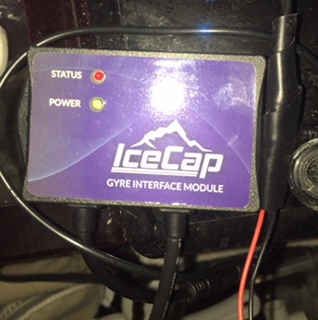

gpsinger
Posts: 7
Joined: Sat Mar 29, 2014 4:05 pm
Re: icecap gyre forward/reverse
Post by gpsinger »
I am using the standard cable the icecap comes with spliced onto a dimming port lead wire to connect to the RA. Do I need to get the modified cable that coralvue sells? Or is there another way? Here's a picture of my icecap if that helps.
If you spliced only one channel, you must splice the other one too.
One controls speed and the other controls direction.

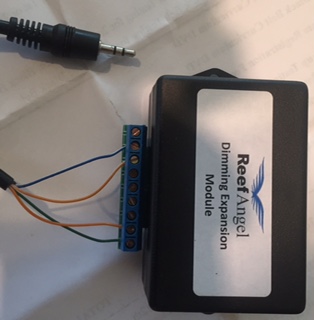

gpsinger
Posts: 7
Post by gpsinger »
I got the alternate gyre mode wire from coralvue and the dimming expansion but I'm not sure I'm wiring it correctly. Any idea which wires are for speed and which for direction?
Wire colors are green, orange, orange with white stripe and blue with white stripe.
First, pretty sure the striped ones are ground. I would bet that the Orange is channel one and most likely speed, while Green is probably the second channel and would leave reverse. I would test and see how it goes.
The kessil cable in the webstore should work too if you don't want to path your own

Post by oftheangels »
Did you ever get the direction control to work?
I have the additional cable and the orange wire on port 1 (speed) and the green wire on port 2 (direction). I've got my forward speed working fine but I have not been able to get the pump to go into reverse. I was under the impression (probably false) that sending 0 volt to the direction channel was forward and sending 1 volt to the direction channel would reverse it?
Am I supposed to be sending the actual speed voltage to the direction channel for reverse? If this is the case I would assume I need to send 0 to the speed channel (in which case port 1 would be forward and port 2 would be reverse)? Any help would be greatly appreciated.
gpsinger wrote:I got the alternate gyre mode wire from coralvue and the dimming expansion but I'm not sure I'm wiring it correctly. Any idea which wires are for speed and which for direction?
I did manage to get direction to work.
The main thing is that you can't have the pump out of the water.
This will only work if the pump is immersed in water and you must go through their initial calibration also with the pump inside the water.
I made the mistake of trying to get this out of the water and I only got strange results.
0%=forward and 100%=reverse
