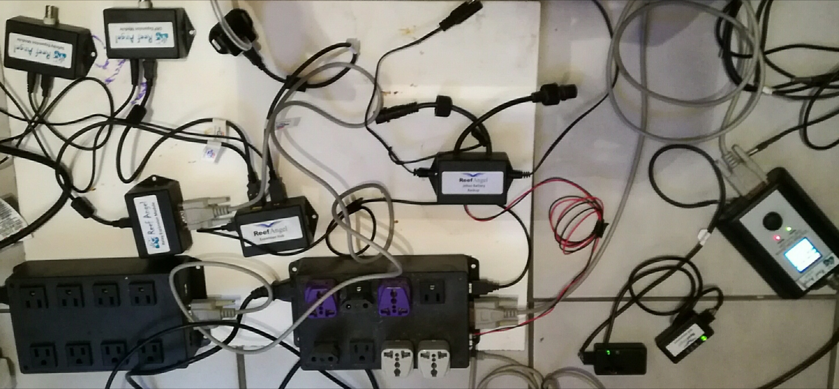

I'm planning on attaching the system to a board and then fixing the board to a wall. Attached a pic.
Do you guys think there will be any problems with it setup in this way anything I can not forsee?
Alternative would be to build a shelf. But that would make access harder

I did something similar. Just make sure you leave enough room to access the connectors. Some of mine ended up a little tight.
