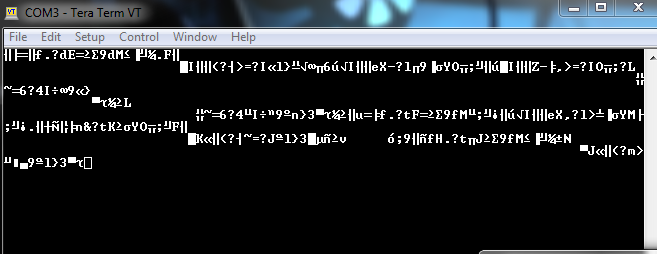

So after I click OK on the start wifly module configuration what do I do? All I see is a bunch of symbols and numbers appear across the screen.
Re: Wifi or app issue?
can you post what you get?
Post by nevets9333 »
You are not connecting with the correct baud rate. It needs to be 57600
nevets9333
Posts: 37
Joined: Fri Jul 04, 2014 8:42 pm
Thank you so much! I truly appreciate your patience and help!
