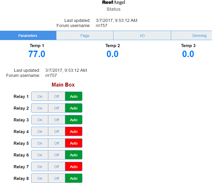

Heater question: I used the heater on standardheater port7. But when I look at the relay - it's always on auto but always red(off) and my temprature is always in the range where the switch should be green any suggestions - I used the wizard to set that stuff up.

- temp/relay status
- controllerstatus.png (26.35 KiB) Viewed 12097 times

Heater will turn on when it reaches 70.0 or below and turn off when it goes above 79.0.
If it is showing off at 77.0, it means it is going down and it will only turn on when it reaches 70.0.

so I changed it both ways, I used the wizard and set to turn on at 70 and off at 79
generated this line: ReefAngel.StandardHeater( Port7,700,790 );
I even reversed it and still no luck, the overheat works but I cant get the plug to go from auto(red) to be on in that range? anything I am doing wrong? I am doing dry runs to make sure everything works before I start plugging it in, the heater is one that I still havent been able to get working. I also tried changing the port and same behavior?

Nevermind, found this in the forums, great explanation from Roberto:
Ok, so let me try to explain this again....
The heater will only turn on when it hit the low temp setting and turn off when it hits the high temp setting.
So, until the temp goes down to 70 degress, the heater won't turn on. The minute it hits 70, it will turn on and it will not turn off until it hits 78 degrees. The minute it hits 78, it turns off and will remain off until it hits 70 degress again and the cycle repeats.
Re: Newbie needs a little help please
for some reason the latter explanation, maybe more verbose helped a dummy like me realize, lol - the wifi fix worked, I am getting there.
