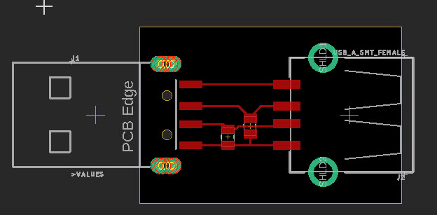

  • I would also recommend trying lower pull-up resistor values for people having bus lock issues with the Reef Angel itself, although refitting a Reef Angel with a different resistor would be a little bit tricky. You could maybe bodge something on to the USB port itself. You don't have to remove the existing pull-up; just add resistors between 5V and each of SCL_5_1 and SDA_5_1
I know this thread is on the older side but maybe you're still hanging around here. Looking at the schematic and board files for the RA*, it looks like the pull-ups for SLC_5_1 and SDA_5_1 are R45C and R45D which appear to be part of a resistor network. As you mentioned, that's not going to be a trivial task to replace. At least not with my coffee hands and bad eyes. Are you saying that if make up some sort of adapter with 4K7 resistors to put between the incoming USB cable for the relay expansion and the RA* that might help with the bus locks? Take a look at the adapter in the attached image.
What did you end up doing on this for your project? Reef Pi? How did that work out for you?
