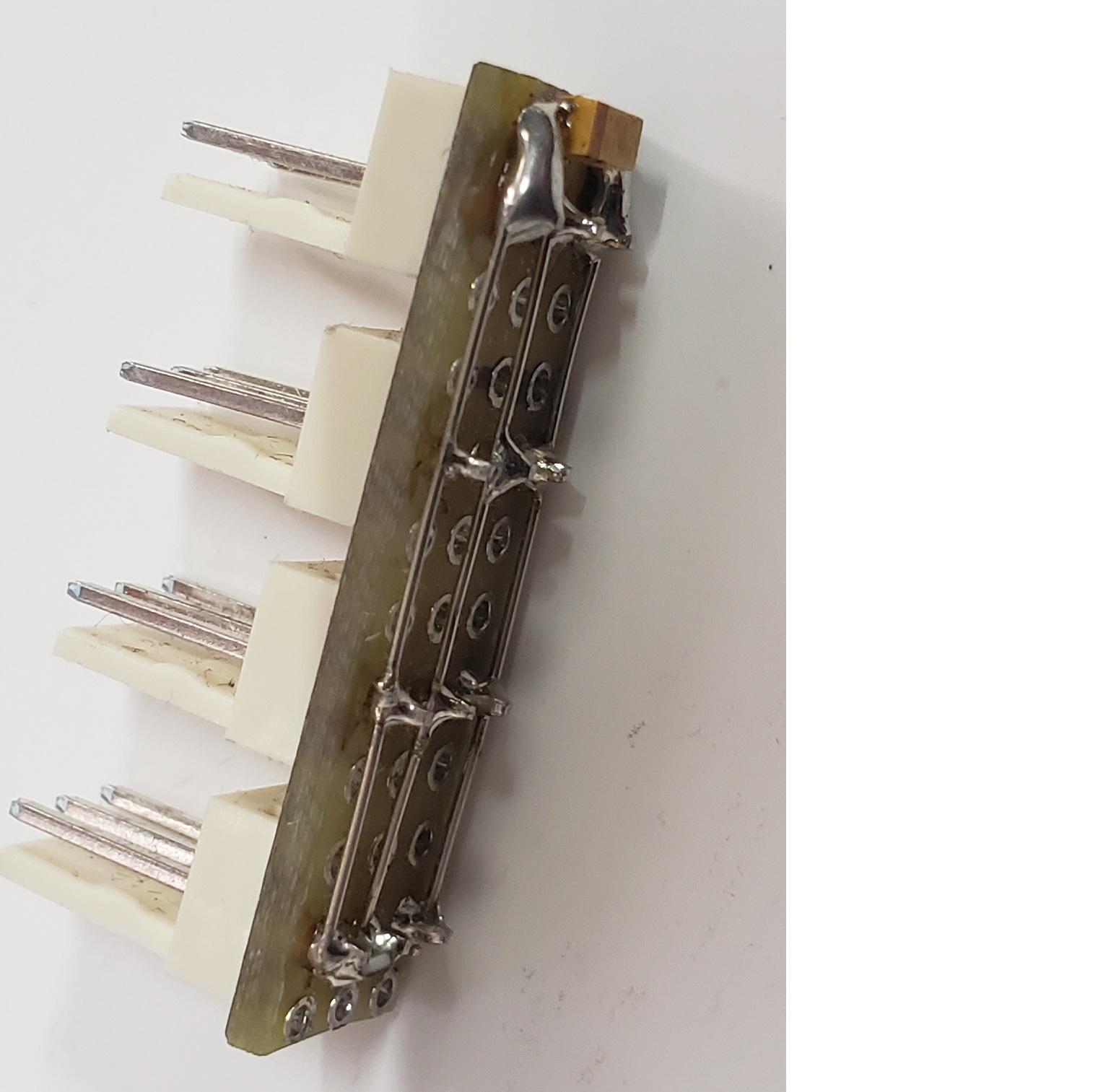

Also, Roberto, when I purchased this unit and rest of hardware, you had sent me this (see attached) small custom connector for temp sensors I believe, I think (I may be wrong) it was to boost the temp sensor signal as one of my sensor wires was extended 30', is that correct? IF so, and I do not plan to use 30' cable I do not need it correct?

You do not need to use the adapter.

That adapter was for what?
