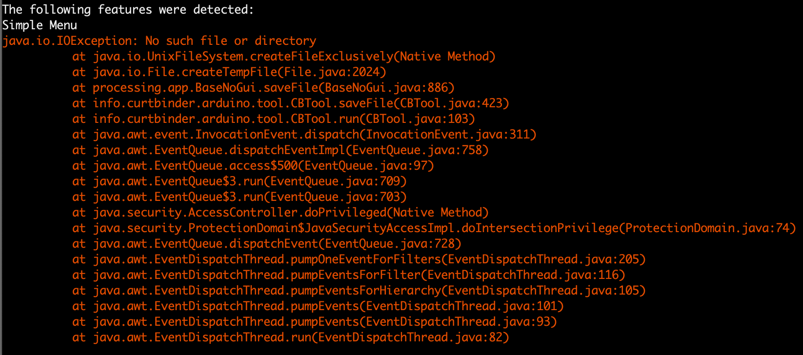

I'm to the steps where I place CBTool folder inside /Arduino/libraries/tools. There wasn't a "tools" folder inside of "libraries", so I made one and dropped the CBTool folder inside it. I quit and relaunched the Arduino app, but I don't have the "CB Reef Angel Process Sketch" under the Tools menu.binder wrote:If you are going to use the regular arduino software, look at this topic for instructions on getting the latest arduino to work.
create your code in the webwizard and then copy and paste it into arduino. save it. then compile and upload.
Sent from my Pixel 2 using Tapatalk
- Posts: 22
- Joined: Mon Oct 19, 2020 1:35 pm
Re: Anyone programming from a Mac?
Figured it out. The path actually needs to be /Arduino/tools (at least in Arduino 1.8.13)
Still running into difficulty.
- Screen Shot 2020-10-25 at 11.57.04 AM.png (223.16 KiB) Viewed 15414 times
Since it was/is a fresh install, you need to create 2 folders inside the libraries folder and potentially 2 files.
Folders:
1. ReefAngel_Features/
2. RA_CustomLabels/
Files:
1. ReefAngel_Features/ReefAngel_Features.h
2. RA_CustomLabels/RA_CustomLabels.h
I guess I should have done better with missing folder checks. Anyways, create those 2 folders and try to run it again. If it still fails, create the 2 files and run again.
Folders:
2. RA_CustomLabels/
Files:

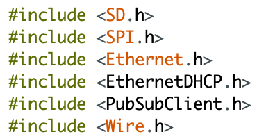

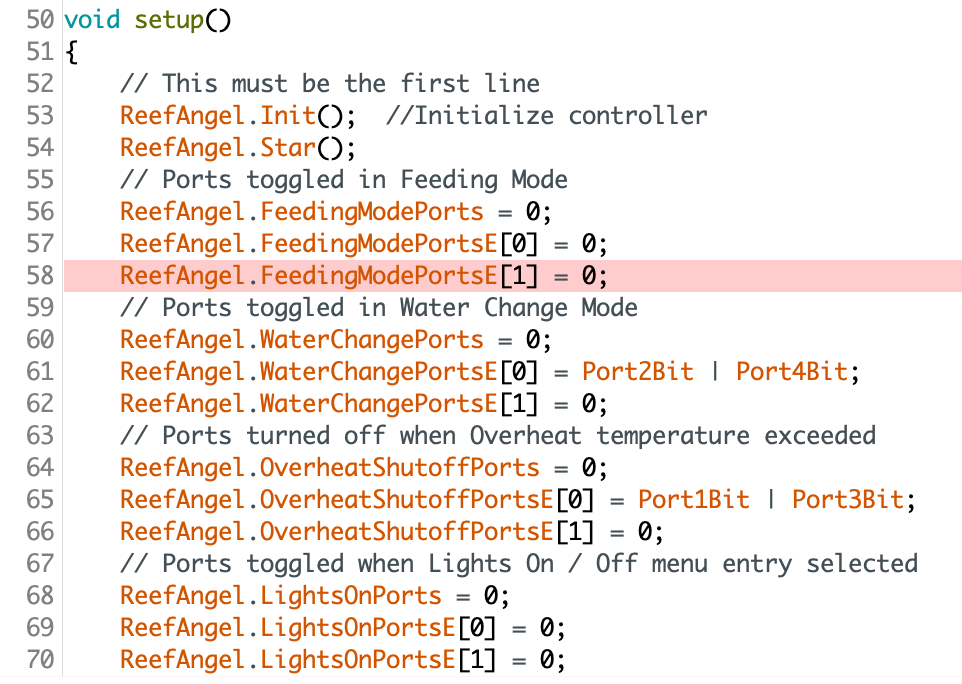

That got me closer! I just created the two folders. The tool created the files for me. But when I go to upload, I get this.
"Reef_Angel_Initial_Setup:1:10: fatal error: Salinity.h: No such file or directory".
Also, I'm not sure why these are red text. One last one not pictured is at the bottom.
#include <SoftwareSerial.h>
- Screen Shot 2020-10-25 at 12.12.10 PM.png (35.26 KiB) Viewed 14933 times
The highlighted text is formatting that the Arduino IDE does for keywords.
If we add the keywords, they turn red or blue depending on how you tag them.
Just a visual thing to make readability easier.
Try using another code. The code you were trying may be obsolete for the RA*.

Reef_Angel_Initial_Setup:57:15: error: 'class ReefAngelClass' has no member named 'FeedingModePortsE'; did you mean 'FeedingModePorts'?
ReefAngel.FeedingModePortsE[0] = 0;
FeedingModePorts
Reef_Angel_Initial_Setup:58:15: error: 'class ReefAngelClass' has no member named 'FeedingModePortsE'; did you mean 'FeedingModePorts'?
ReefAngel.FeedingModePortsE[1] = 0;
FeedingModePorts
Reef_Angel_Initial_Setup:61:15: error: 'class ReefAngelClass' has no member named 'WaterChangePortsE'; did you mean 'WaterChangePorts'?
ReefAngel.WaterChangePortsE[0] = Port2Bit | Port4Bit;
WaterChangePorts
Reef_Angel_Initial_Setup:62:15: error: 'class ReefAngelClass' has no member named 'WaterChangePortsE'; did you mean 'WaterChangePorts'?
ReefAngel.WaterChangePortsE[1] = 0;
WaterChangePorts
Reef_Angel_Initial_Setup:65:15: error: 'class ReefAngelClass' has no member named 'OverheatShutoffPortsE'; did you mean 'OverheatShutoffPorts'?
ReefAngel.OverheatShutoffPortsE[0] = Port1Bit | Port3Bit;
Reef_Angel_Initial_Setup:66:15: error: 'class ReefAngelClass' has no member named 'OverheatShutoffPortsE'; did you mean 'OverheatShutoffPorts'?
ReefAngel.OverheatShutoffPortsE[1] = 0;
Reef_Angel_Initial_Setup:69:15: error: 'class ReefAngelClass' has no member named 'LightsOnPortsE'; did you mean 'LightsOnPorts'?
ReefAngel.LightsOnPortsE[0] = 0;
LightsOnPorts
Reef_Angel_Initial_Setup:70:15: error: 'class ReefAngelClass' has no member named 'LightsOnPortsE'; did you mean 'LightsOnPorts'?
ReefAngel.LightsOnPortsE[1] = 0;
LightsOnPorts
/Users/rsweeney/Documents/Arduino/Reef_Angel_Initial_Setup/Reef_Angel_Initial_Setup.ino: In function 'void loop()':
Reef_Angel_Initial_Setup:96:29: error: 'class ReefAngelClass' has no member named 'BuzzerOn'
if ( buzzer ) ReefAngel.BuzzerOn(2); else ReefAngel.BuzzerOff();
Reef_Angel_Initial_Setup:96:57: error: 'class ReefAngelClass' has no member named 'BuzzerOff'
Reef_Angel_Initial_Setup:103:23: error: 'class RA_Wifi' has no member named 'Cloud'
ReefAngel.Network.Cloud();
Reef_Angel_Initial_Setup:105:15: error: 'class ReefAngelClass' has no member named 'ShowTouchInterface'; did you mean 'ShowInterface'?
ReefAngel.ShowTouchInterface();

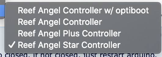

any changes to the libraries needs to be done with arduino closed. if not closed, just restart arduino.
once restarted, make sure that you have the proper board selected (reefangel board that is).
run the cb tool parser again (just to make sure).
then try to compile the code.
arduino is a little finicky with its libraries and all.

Running your tool is successful. It's only when I verify the code is when I get these class errors. Again, the code I have is a straight copy/paste from the web wizard.
- Screen Shot 2020-10-25 at 4.10.12 PM.png (148.5 KiB) Viewed 14931 times

Does this code snippet look right?
- Screen Shot 2020-10-25 at 4.33.15 PM.png (184.14 KiB) Viewed 14929 times

that extra [1] is not needed because you don't have 2 relay boxes. remove those references.ReeferRyan wrote:Does this code snippet look right?
FeedingModePortsE[1] (or whatever it is exactly)
you are referencing an element of an array that doesn't exist. Those port arrays are only the size of expansion boxes. I think the wizard messed up generating that code. you only have 1 relay box with the star, so remove all the lines that reference the 1st index (second item in array).

I did that, but it's still complaining about:binder wrote:that extra [1] is not needed because you don't have 2 relay boxes. remove those references.ReeferRyan wrote:Does this code snippet look right?
I'm stumped and getting frustrated with it.
