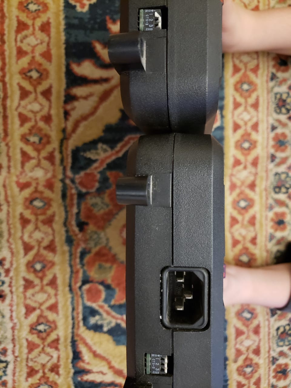

I want to connect 2 relay boxes to reef angel star but the don't work together at all please i want help :cry: :cry: :cry:

You need to change the ID. Please check the manual and change the ID on one of the boxes.

I didn't find any useful info and I tried to change their id as in the table in the manual of the relay expansion but it still reads only one relay
Re: having trouble in connecting multiple relay boxes
Each box needs to be a different ID.
First box is ID 1 and second box is ID 2

Like this ??

Yes

Thank you very much it worked from the mobile but on the reef angel screen I can't find the 2nd relay.
do you have any idea how can I display it?
Does your code have 2 relay boxes?
