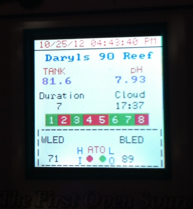

I want to get the display to show the Cloud duration on the left side of my screen like it does now and I also want to Show when the next cloud is on the Right side of the screen.. It shows 10:00 now which isn't correct since thats not in my parameters.. I think I'm close yet again but Heres Code..

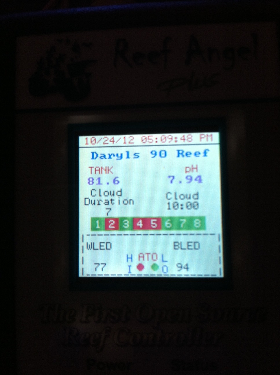

ReefAngel.LCD.DrawText(0,255,12,51, "Cloud");
ReefAngel.LCD.DrawText(0,255,6,59, "Duration");
ReefAngel.LCD.DrawText(0,255,26,69,cloudduration);
if (LastNumMins!=NumMins(hour(),minute()))
LastNumMins=NumMins(hour(),minute());
ReefAngel.LCD.Clear(255,0,120,132,132);
ReefAngel.LCD.DrawText(0,255,82,55,"Cloud");
ReefAngel.LCD.DrawText(0,255,82,64,"00:00");
//ReefAngel.LCD.DrawText(0,255,45,120,"L");
//ReefAngel.LCD.DrawText(0,255,51,120,"00:00");
if (cloudchance && (NumMins(hour(),minute())<cloudstart))
int x=0;
if ((cloudstart/60)>=10) x=48;
else x=54;
ReefAngel.LCD.DrawText(0,255,82,64,(cloudstart/60));
if ((cloudstart%60)>=10) x=66;
else x=72;
ReefAngel.LCD.DrawText(0,255,82,64,(cloudstart%60));

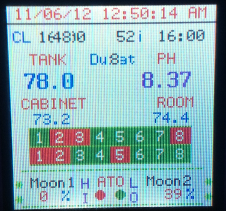

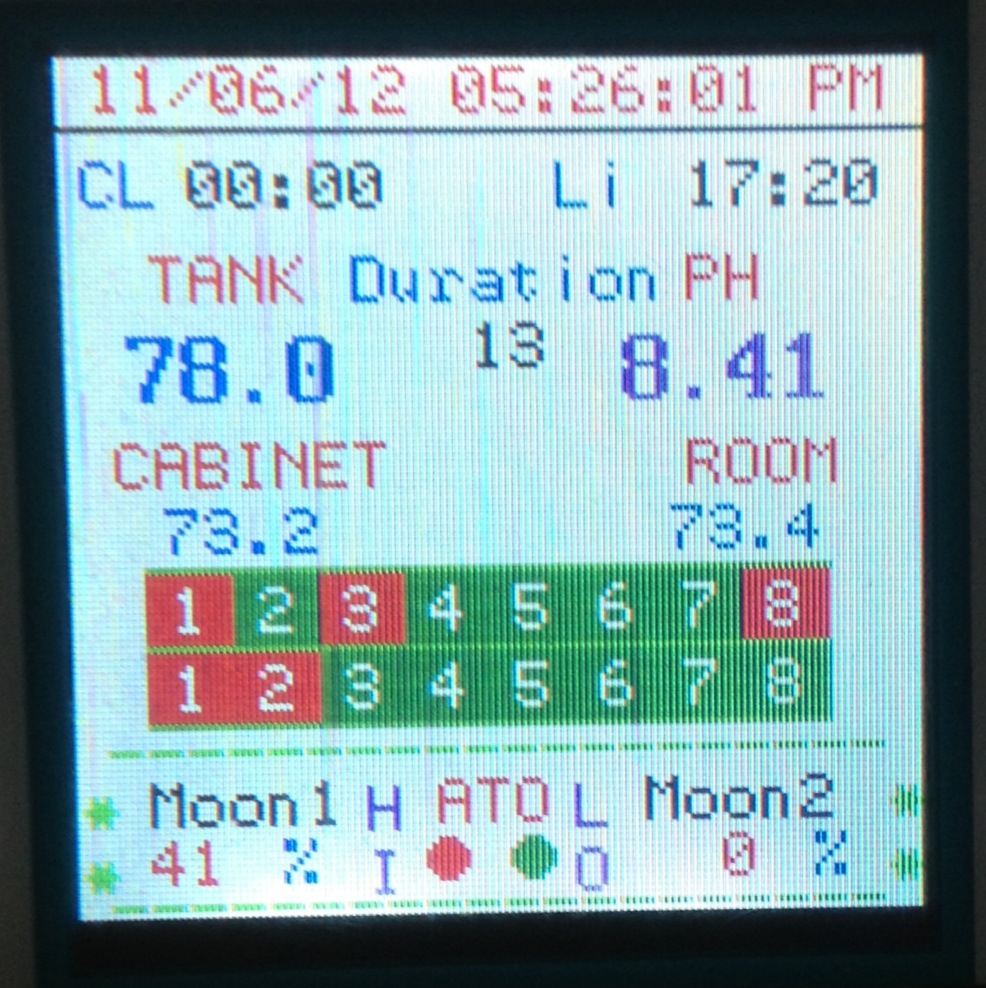

See this?
This will draw 00:00
You have to overlap:
if ((cloudstart/60)>=10) x=48; else x=54;
ReefAngel.LCD.DrawText(0,255,x,57,(cloudstart/60));
if ((cloudstart%60)>=10) x=66; else x=72;
ReefAngel.LCD.DrawText(0,255,x,57,(cloudstart%60));
ReefAngel.LCD.DrawText(0,255,56,119,cloudduration);
if (lightningchance)
int x=0;
if (((cloudstart+(cloudduration/2))/60)>=10) x=51; else x=57;
ReefAngel.LCD.DrawText(0,255,x,115,((cloudstart+(cloudduration/2))/60));
if (((cloudstart+(cloudduration/2))%60)>=10) x=69; else x=75;
So you change the x= values to over lap "00:00" these output calculations.
It sure took me some time to get it exactly right...

Finally Got it after playing for a bit.. Lol
Pictures Below...
Pictures Below...

Very nice! It's tricky for sure. But lOoks really good!

ReefAngel.LCD.DrawText(0,255,6,55, "Duration");
ReefAngel.LCD.DrawText(0,255,24,66,cloudduration);
ReefAngel.LCD.DrawText(0,255,84,55,"Cloud");
ReefAngel.LCD.DrawText(0,255,84,66,"00:00");
int x=0;
if ((cloudstart/60)>=10) x=84; else x=90;
ReefAngel.LCD.DrawText(0,255,x,66,(cloudstart/60));
if ((cloudstart%60)>=10) x=101; else x=108;
ReefAngel.LCD.DrawText(0,255,x,66,(cloudstart%60));

Ok been working on my code and to save my life I cant get it to work as far as the x and y values for cloud and lightning. Any help appreciated here is my code and a pic of my screen......code first:
ReefAngel.LCD.DrawText(COLOR_BLUE,255,4,16,"CL");
ReefAngel.LCD.DrawText(0,255,20,16,"00:00");
ReefAngel.LCD.DrawText(COLOR_BLUE,255,75,16,"Li");
ReefAngel.LCD.DrawText(0,255,95,16,"00:00");
ReefAngel.LCD.DrawText(COLOR_BLUE,255,52,30,"Durat");
int x=0;
if ((cloudstart/60)>=10) x=20;
else x=26;
ReefAngel.LCD.DrawText(0,255,x,16,(cloudstart/60));
if ((cloudstart%60)>=10) x=29;
else x=35;
ReefAngel.LCD.DrawText(0,255,x,16,(cloudstart%60));
ReefAngel.LCD.DrawText(0,255,65,30,cloudduration);
int x=0;
if (((cloudstart+(cloudduration/2))/60)>=10) x=95; else x=101;
ReefAngel.LCD.DrawText(0,255,x,16,((cloudstart+(cloudduration/2))/60));
ReefAngel.LCD.DrawText(0,255,x,16,((cloudstart+(cloudduration/2))%60));
int x=0;
else x=26;
else x=35;
int x=0;

Re: Clouds and display
Man if ya only knew how many hrs i have done tried with them darn x's and y's.....lol ya would understand why ive been tempted to throw the whole dang thing out the window....lol Seriously I just cant seem to get it lined up to get it to work properly...........this is the only part i should be fooling with correct?
int x=0;
else x=26;
else x=35;
int x=0;

Think I have it now, it is working, here is the part of code i been playing with and a picture of screen
ReefAngel.LCD.DrawText(COLOR_BLUE,255,44,30,"Duration");
int x=0;
if ((cloudstart/60)>=10) x=20; else x=26;
ReefAngel.LCD.DrawText(0,255,62,40,cloudduration);
int x=0;
if (((cloudstart+(cloudduration/2))%60)>=10) x=113; else x=119;
int x=0;
int x=0;
- photo3.JPG (298.7 KiB) Viewed 7016 times
- DrewPalmer04
- Posts: 818
- Joined: Tue May 29, 2012 2:12 pm
- Location: Christopher, IL
You've got the hang of it. Nice work!
