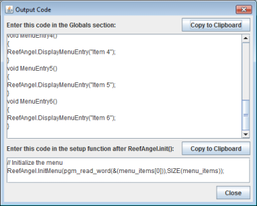

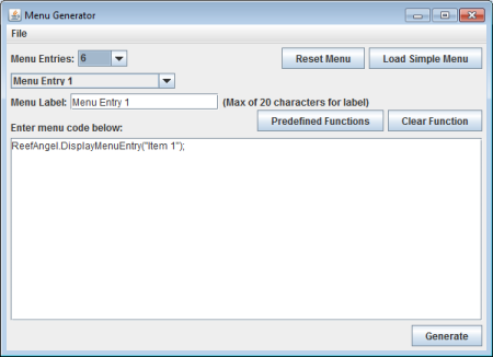

Since RAGen is no longer in use, there is not an easy way to create a custom menu for your controller. I took the custom menu section from RAGen and converted it into a Java application.
It will generate the code and display it in a window to be pasted into your INO file. You have the option to save the menu to an XML file for easy sharing. You can also load the menu from an XML file.
Here are a couple screenshots to show you what it looks like:
Main Screen
Main Screen
Output Screen
Output Screen
I have it released and ready for use. There is a Windows/Linux version which is just the JAR file that you can download and run. The Mac version is a DMG file. The DMG file just opens up and allows you to run the application or you can install it in your Applications by dragging it into your app folder.
