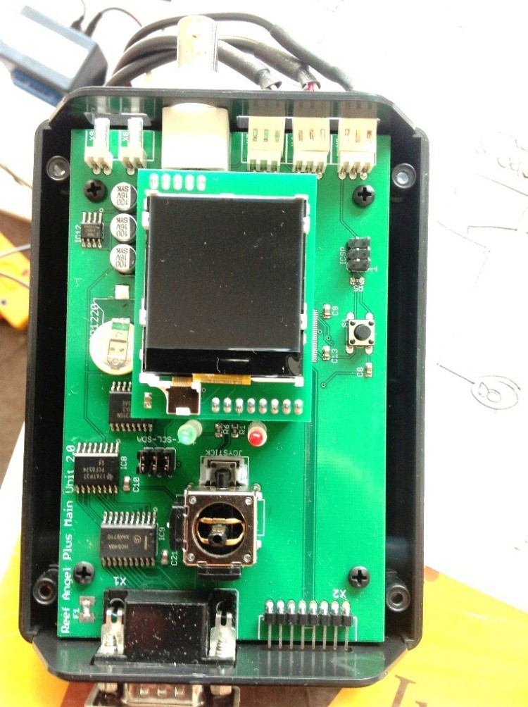

Can you double check if you got the 2 jumpers (SCA/SCL) in the head unit?
ReeferSteve
Posts: 3
Joined: Sat May 19, 2012 3:46 am
Re: PWM and Steve's LED Help
Post by ReeferSteve »
Yip, attached below is a picture of the board.
Got the jumpers on.
Picture of board
Picture of board
Ok, can you follow the steps here and paste the results?
http://forum.reefangel.com/viewtopic.php?p=14763#p14763
