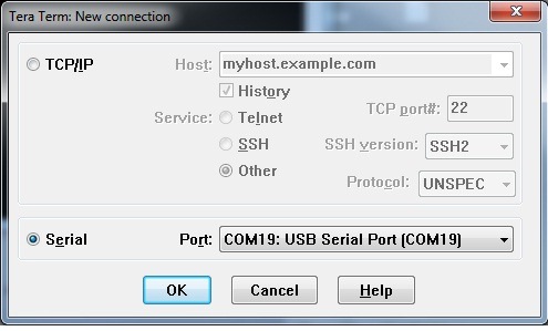

Thanks Appleseed. Tera Term won't even connect. I'm getting "Connection timed out error". I'm stepping through the setup exactly as stated in the manual but it won't seem to connect. I'm assuming you wanted me to run those commands via the Tera Term, correct? Thanks again.

when you open teraterm and you select serial on does it say com x: usb serial?
- tt.jpg (37.9 KiB) Viewed 6613 times

the only other thing i can think of is the cable connected to the module correctly, as per step 2.
or maybe try using putty or hyperterminal to connect.
Re: wifi 0.0.0.0:2000 address
Thanks for your help Appleseed. I was monkeying around with and it looks like I finally got an IP address. I'm going to run through the rest of setup to see how things go. Thanks again.
