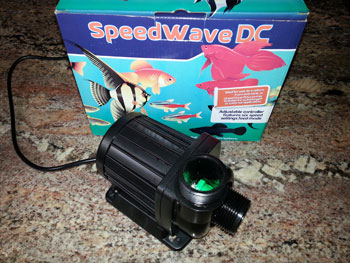

Hey guys,
I got myself one of those SpeedWave DC pump last week, but only had the time to get around to take a look at it today.
I was told they had the same connector as the Jebao pumps.
Guess what???
It's identical!!!
What does it mean?
It means that we can control all these pumps too :twisted:
They are all made in China and sold at various different names: Diablo, SpeedWave, Waveline, Jebao, Boyu and who knows how many more.... :roll:
They use the same technology as the Jebao pump, so we already have the cable, which in turn means we are all set for more controllable things for us to play with :)
Isn't it nice of the Chinese manufacturers to create something we already can control :mrgreen:

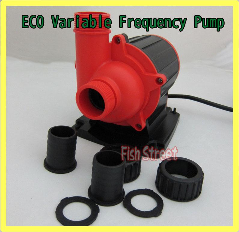

As far as I know, there are 5 different alternatives regarding these DC return pumps.
Can we tell which one is controllable by RA and which not? :?
I guess Rimai you are refering to No.3?

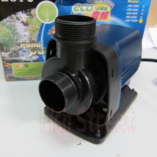

1. Boyu pump (GX4P model) with the 3 speed dial at the back of the pump (like the photo Joost uploaded)
2. Boyu pumps (JNB & GXB models) without any speed dial or control box.
3. SpeedWave & Waveline DC pumps DC 3.000/5.000/10.000 with 6 speed control box (The "current / old" model)
4. Waveline DC pumps DC 4.000/6.000/12.000 with control box (The "forthcoming / new" model). From what I've read in respective RC thread, they will start selling with the old control box (the right one in the photo). I quote:
"All of the new 4000, 6000, and 12000 pumps will only come with the basic controller out of the box, which is NOT capable of 0-10v input. As the photo shows above, there will be an additional controller available that will need to be purchased for the 0-10v capability"
5. Jebao DC pump without control box or speed dial

Yes, I used #3 and I just placed online yesterday.
I'm quite happy with it :)
I got the 5000 version.
It's actually quieter than the one I was using before, which was some unknown brand :( Eco something... :?
The pump starts very slow and speeds up to whatever speed you chose within 30 seconds. So, you don't get that initial rush of water you get from other pumps.
I initially used the controller that came with the unit and I wasn't able to go past the 2nd speed level. It has 6.
The 3rd speed level would pump more water than my drain was designed and I was getting water being raised to the air intake and causing it to go into full siphon, which caused inrush of water until air was allowed again and gurgle.
So, I left in the second speed level while I was reworking my code.
I disconnected their controller and let RA control it after I changed my code.
I found out that at 50% is when the pump breaks even with the amount of head I have. It's about 5 feet.
I played around for a bit with the % and settled for 60%, which seemed to be the same speed as the 2nd speed level of their controller.
Going back to your question, by just looking at the photos, I can only tell that #3 works, because that's the one I'm using. #4 has the same connectors, so it seems it will work too. #1 doesn't seem to have any controllability with 3rd party controllers, since it has a dial method. #2 may or may not. The only way to tell is by looking at the end of the cable that is not shown in the photo :(
