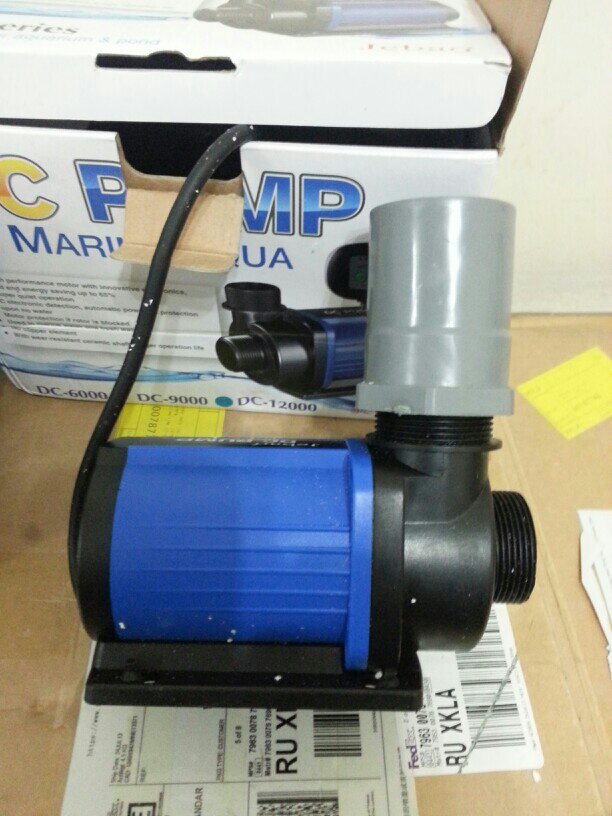

Post by wideawake »
Got mine today. Dry fitted a 1.5" fitting and it looks like it went in a few turns. Not sure if it will leak water if mounted externally.

Post by wideawake »
Yeah, planning to put teflon. But if u see the photo, that's the most I can screw in without forcing it. It's like 3-4mm in only. I'm afraid forcing it might crack it.

Post by Piper »
jerry27 wrote:ive never heard of a plastic thread connection that didnt leak without some form of thread sealer/teflon tape.
And I've had more than my fair share leak with teflon!
