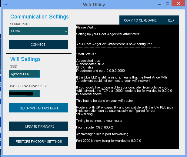

Hi,
I was having issues with the setup, where the connection would only occasionally work on my home network with a couldn't connect message coming up. I hadn't approached port forwarding.
Because of this and the antiquated modem/router I had, I have changed my cable modem to a cg3100D-2 modem/router combo. I am having a hard time as it won't produce an ip, I am just getting 0.0.0.0:2000 . The green light is flashing.
RAWIFI IP.png (40.45 KiB) Viewed 29994 times
Can anyone tell me what to do?
Cheers
Cody

Re: How to setup your wifi attachment
You have DHCP false... is your router running DHCP? Otherwise you'll need to set a static IP on the wifi module. Also make sure your router is set for AES-2 I believe and no spaces in the password.

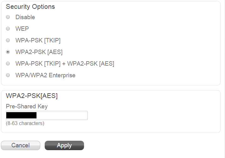

lnevo wrote:You have DHCP false... is your router running DHCP? Otherwise you'll need to set a static IP on the wifi module. Also make sure your router is set for AES-2 I believe and no spaces in the password.
Hi Inevo,
Sorry for the delay.

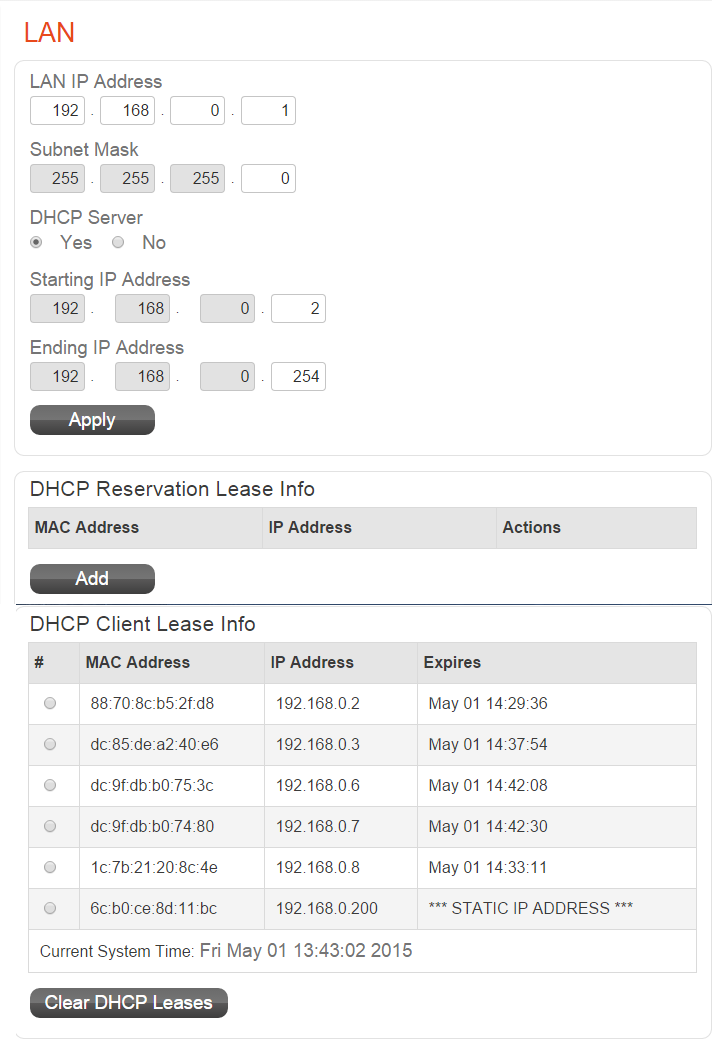

I just installed another modem/router my internet provider (telstra) sent out :roll: . It is a Netgear C6300BD.
I am having the same issue as before.
Have logged in and had a look, seems to run DHCP?
Also the security key stuff is solid numbers and see below:
How do I set a static IP on the wifi module?
Cheers
Cody
That means your unit is already connect to your router.
Just check the connected devices in your router and you should the wifi attachment as one of them.
