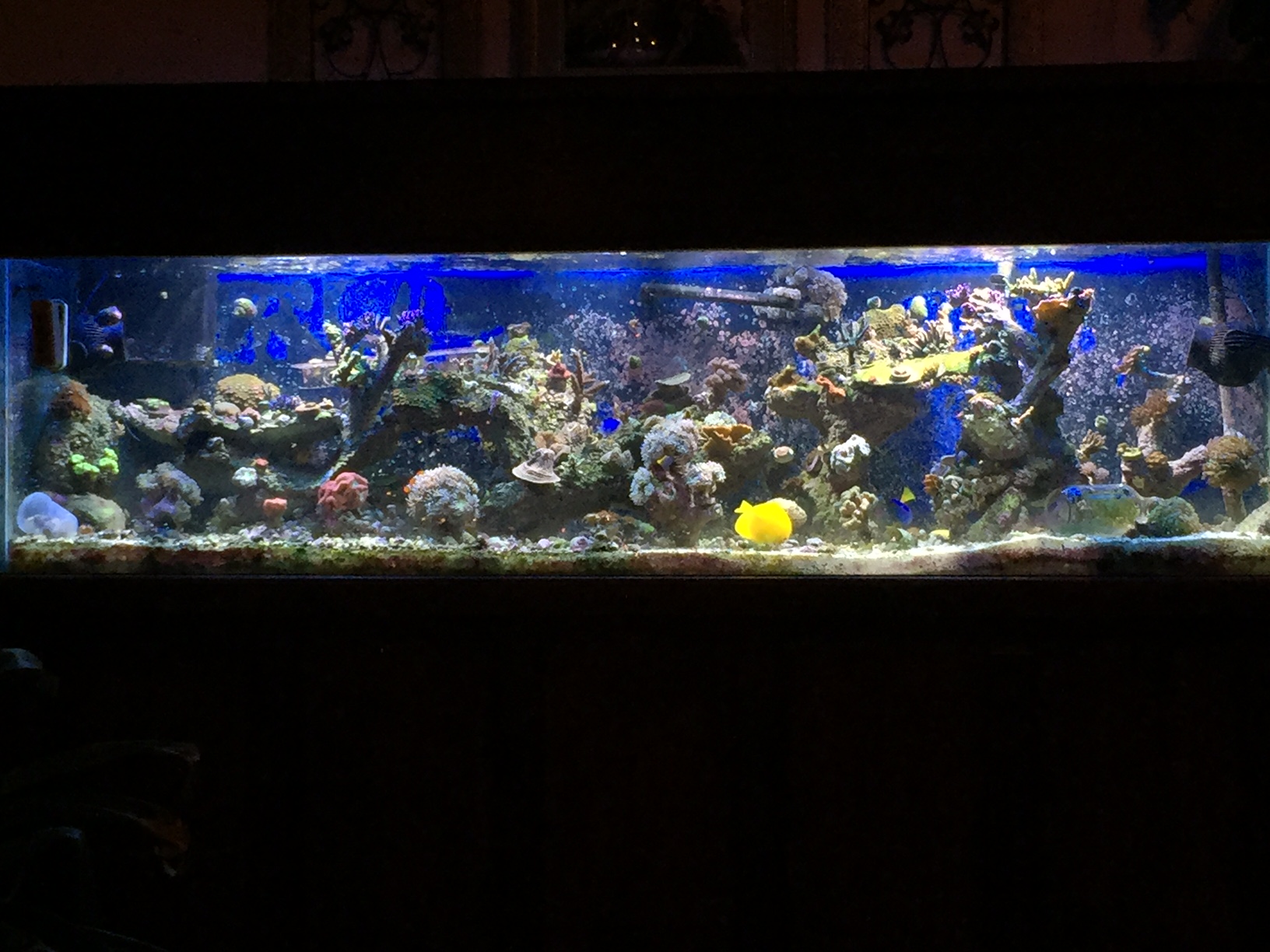

My Tank 125 Gallon LPS/SPS Dominated Tank
