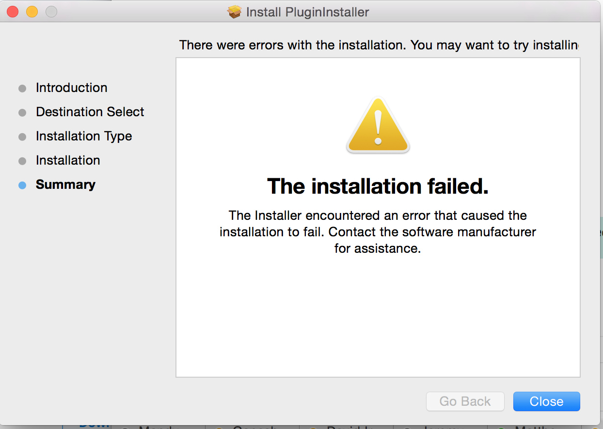

Just tried to install this on the mac and the installer failed. Not a very descriptive error either :?
error screenshot
error screenshot
Screen Shot 2016-11-30 at 5.24.49 PM.png (132.13 KiB) Viewed 23839 times
Re: Reef Angel Web Wizard
What kind of Mac, what OS are you running?
I've got a hacked MacPro (2007) running El Capitan working OK. Not sure what kind of debug could be done... Roberto?
