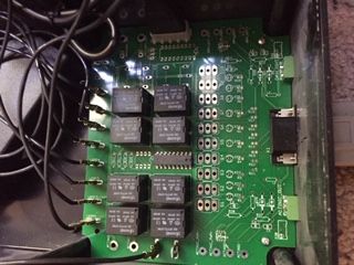

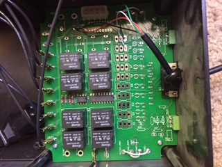

Here are the 2 boards one with the usb added then other not. They look the same to me ,but Im not the expert. I see that one is PWM. ?

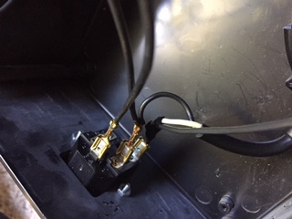

Also I noticed the white wire to the power supply goes to a different terminal in the box? I added the tape due to frayed wires.I added some extra soldier also.Should one be switched? Thanks again.

Re: USB Port.
You can try soldering the USB just like the same one that you already have.

Whats your take on the power supply wiring. I tend to want to switch it to the way the box without the USB is .Due to that box has never failed and the other one has twice. Any replacement power supply?I don't see them in the store.If so PM me. Thanks again.
Re: USB Port.
I don't carry them anymore, but any 12V and 5V would work for you.

Thanks for the help.I got the USB soldiered in and its works perfect.
