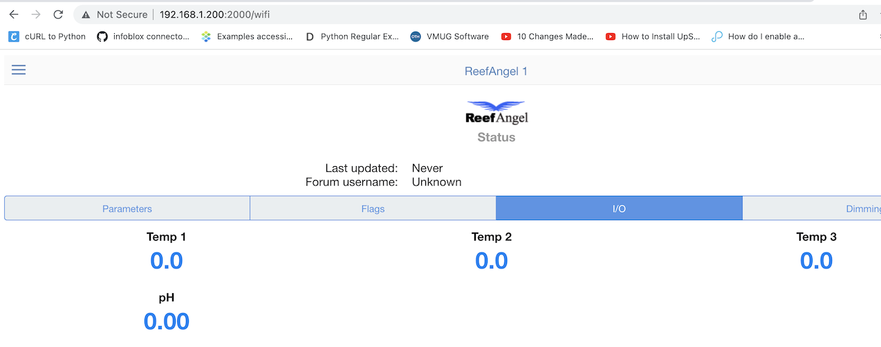

It is when I try the 'wifi' page that I get the following:
wifi page.png (58.43 KiB) Viewed 9044 times
This is odd because the portal seems to be able to obtain the data just fine:
So according to a traffic capture I am communicating over http/1.1 between my MacBook and the Controller fine. I can see a Get /wifi issued and a http://200 response when I request data. But in the text returned with the 200 I am seeing an html <object type> http://www.reefangel.com/wifi3/content.html [cut] </object type>. I then see port 80 HTTP traffic between my MacBook and the Reef Angel site, each with a TCP ACK.
Look at the trace you would think things are working.
Running the call to for http://www.reefangel.com/wifi3/content.html from Postman, I get an HTML document with a number of JAVA scripts. I am beginning to think, this is a JAVA/MacBook issue or a JAVA latests Browser issue.

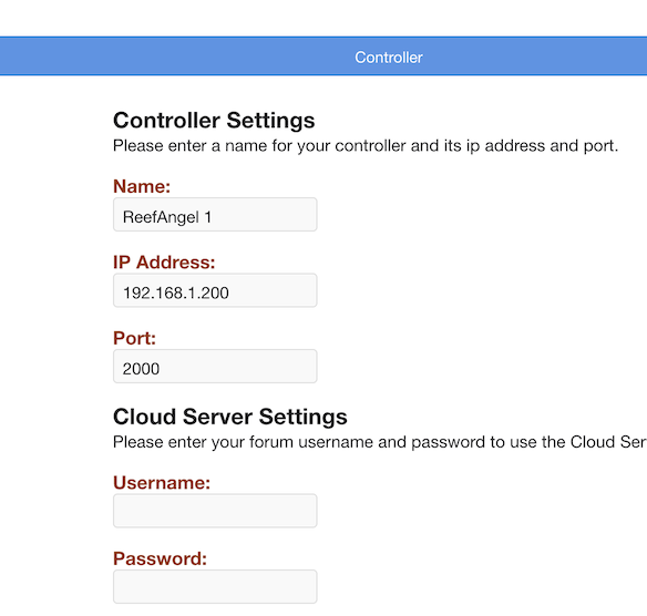

By the attached photo above, it seems you are somehow entering the cloud username and password, which would force uapp to use the cloud server. You do not have the cloud wifi attachment.
So, please delete that controller and add a new one, but this time make sure to not enter anything on username and password. Just enter the ip address and port. You should not see "Cloud Server: Connecting..."
madmarks
Posts: 20
Joined: Fri Apr 16, 2021 7:06 pm
Re: Local Web Page Not Connecting
Post by madmarks »
Roberto;
I have done so. I even changed the profile(server) name & the IP address handed to the Controller to ensure it not some weird cached credentials issue. I have let it run for an hour.
I am getting the same non-update. Does the sever name need to match something exactly?
