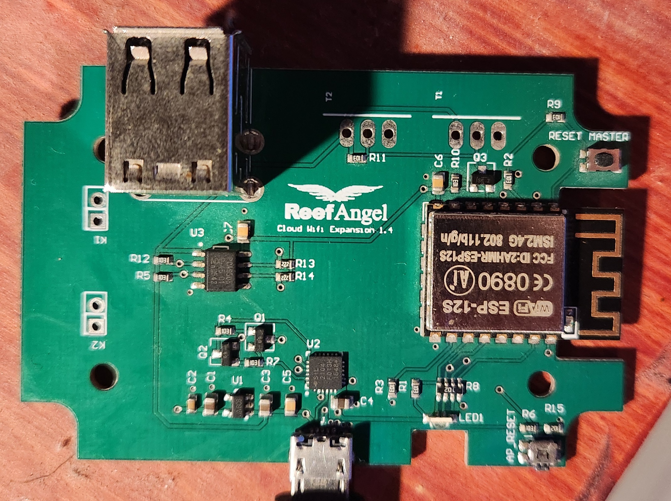

I don't see the pin hole that you're referring to. I've attached an image of my board.
Tim

Click on AP Reset while its connected to wifi and that will update the device
Sincerely, Brennyn
