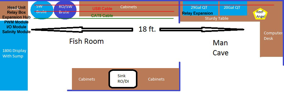

Here is an image of my physical layout of my fish room and my man cave.
http://warpig.dyndns-web.com/tank/Layout.jpg
Here is what I want to accomplish.
I would like to put the Reef Angel + in my man cave by my computer.
pro's/con's of this placement?

If you look at my diagram and my original post and understand generally what I am trying to accomplish and lets just say that I would be willing to move the controller/other items to wherever it made the most sense and made things easier can you give me an idea of how you would approach my install? I am trying to keep my hookup as simple as possible too as it will help prevent intermittent issues and other possible problems. Just having a bit of trouble because I dont have any hands on with the hardware. maybe your intimate knowledge of the device can help me get a better understanding.

Re: HELP! What do I need to pull this off?
I'd do something like this.
You can run the temp sensor through the cat 5.
The shorter USB cable is used to connect the hub to the relay expansion.
The longer USB cable is used to connect the computer to RA.
00Warpig00
Posts: 289
Post by 00Warpig00 »
Thanks for taking the time to mark up my diagram and give me your input. I'm going to chew on that a little bit. I'm sure i will come back with another slew of questions shortly. Looked at the manuals and have re read a few of them and have a little better understanding of the hookups.

00Warpig00
Posts: 289
So here is what I have been working on for the past several days. I did this to visualize what my end goal is, as well as how I would attempt to set this all up. I'm not sure my understanding of everything is correct and I have it all correct, but based on what I have read and any feedback you can give me I'm sure this will provoke the next questions I may have. If it's not too much trouble can you help me pick this apart to help me understand better.
Looks like I'm looking at quite an investment in Reef Angel hardware. Do you have any kind of large purchase discounts? I'm at ~$700 and I haven't found the salinity module\probe or IO Modules on your store to add to my cart yet :shock: :ugeek: I'm sure you can understand my concern with placing an order this size. I'd hate to make this investment and find out that it falls short of my goals based on my purchasing without fully understanding the products.
Again thanks for your help and feedback.
Hi Nick,
Wow. Pretty cool drawing :)
Your diagram is dead on.
There is not one thing to be changed :shock:
