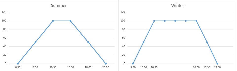

I would like a little help and input on how I would calculate changing the durations (slope) of rising and setting time.
So, as hours per day increase, the duration increases. As hours per day decrease, duration decreases giving the tank the same amount of (insert proper word here... solar radiation??)
I know how to accomplish this in the code, just looking for input on what sort of numbers to apply so the tank is getting "the same amount of light" throughout the varying day lengths.
In my mind this would be something like the period of the curve decreases the duration increases (slopes get steeper) keeping the area under the curve the same? Would that be what I am looking for? Not exactly to scale, but a reference.

Some quick calculations in excel calculating area under a curve with about a 4 hour per day swing between summer and winter shows I can swing the duration from 2.5 hours for the longest day to 0.5 hours for the shortest day instead of shortening the daylight duration. The duration of 2.5 hours is Actinic Offset as well as the slope duration giving 5 hours or rise time until max light.
Is this data viable and work the way I think it should?

So this is the code I ended up using in case anyone else wants to so something similar.
In this scenario, ActinicOffset = Slope Duration.
On the longest day of the year my Actinic lights take 2.5 hours to ramp up to max and then the daylights turn on and take 2.5 hours to ramp up to max.
On the shortest day the Actinic lights take 1 hour to ramp to max and then the daylights turn on and take 1 hour to ramp to max.
I based these numbers on the attached spreadsheet factoring in MAX hours of day light vs. the Area under the curve in hopes to even out the strength vs. length of daylight swing in order to maintain actual sun rise and sun set times for my location.
DayMins = ((NumMins(sl.GetSetHour(), sl.GetSetMinute()))-(NumMins(sl.GetRiseHour(), sl.GetRiseMinute())));
int duration = map((DayMins), 850, 615, 150, 60);
InternalMemory.ActinicOffset_write(duration);
InternalMemory.PWMSlopeDuration1_write(duration);
InternalMemory.PWMSlopeDuration2_write(duration);
InternalMemory.PWMSlopeDuration3_write(duration);
InternalMemory.PWMSlopeDuration4_write(duration);
InternalMemory.PWMSlopeDuration5_write(duration);
ReefAngel.CustomVar[3]=duration;On the longest day of the year my Actinic lights take 2.5 hours to ramp up to max and then the daylights turn on and take 2.5 hours to ramp up to max.
