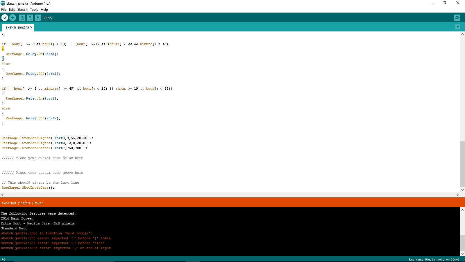

I am getting this error when I post the code. Its changed slightly, did I miss something?
Watchdog Timer
Version Menu
2014 Main Screen
Extra Font - Medium Size (8x8 pixels)
Standard Menu
sketch_jan27a.cpp: In function 'void loop()':
sketch_jan27a:76: error: expected `)' before '{' token
sketch_jan27a:79: error: expected `)' before 'else'
Code:

Re: Some strange issues
Yeah, this part. You have extra parentheses. Just click "Select All" on the code I posted, copy, then paste into Arduino.

Same Error

ReefAngel.Relay.On( Port5 );
if ((hour() >= 5 && hour() < 10) || (hour() >=17 && (hour() < 22 && minute() < 45)
***Here is where it states the error is***

See screen Capture
See screen Capture

Sorry, Like I said i am new.. Please bear with me.
I didn't realize I wasn't copying the editor
Stupid parentheses. :oops:

I was trying, resolved the first one, but couldn't figure out the second set.
My Wifi Controller should come tomorrow, so i might change up a little, but what you've helped me with is beginning to make sense. Hopefully I can do a little coding (sheer attempt at this point) this weekend and see what I can come up with.
Thanks again! Sincerely Appreciated!!!
