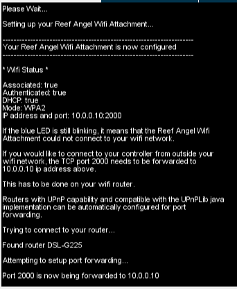

- Installed and connected the wifi attachment to our home network. (received the following message)
Wifi connection status.PNG (23.31 KiB) Viewed 15194 times
Based on the message I gathered that my reef angel IP address is 10.0.0.10 and that port 2000 has successfully been opened on my router.
I did the test by inserting the IP address into my browser and was able to successfully turn the relays on and off.
However I cannot see my data on the portal nor on the app.

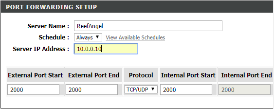

I entered by home networks IP address and added the IP address of the Reef Angel (ie 10.0.0.10) to be accepted via port 2000 (please refer to image below)

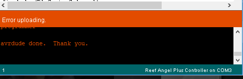

Every time I upload the code it runs through the process, reboots the controller but indicated "Error uploading" (please refer to image)

After forwarding the port on my router I can now no longer access 10.0.0.10:2000 via my browser as I could have done previously.
The portal still does not identify my controller neither does the app.

Every time I try to upload my own web wizard generated code I get the same messeage as on the first page “error uploading”
Re: New Reef Angel User
That board may be bad. We know your usbttl cable is good otherwise you wouldn't be able to program the wifi attachment
