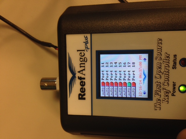

I see them on the controller lcd screen
screen 1
screen 1
photo 2.JPG (97.21 KiB) Viewed 3873 times
when I toggle over I then see this, and says port 17 on
photo 1.JPG (118.98 KiB) Viewed 3873 times

my apologies, 18 ports
Re: *New User*-Why do I have 16 ports on controller
Because you've defined a relay on the second box :)
ReefAngel.Relay.On( Box1_Port7 );
As soon as it sees BoxX it will add that relay bar.
